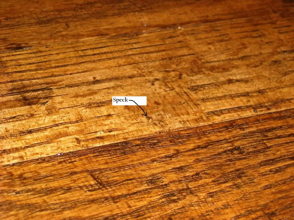

    Ok, now I am getting close to finishing this floor but have noticed little specks in the finish after using Varathane. After the first coat, there were small specks of what looked like balls of stain covering the floor. I had 24 hours between coats and sanded, then applied Varathane again, only to have specks again. They were fewer in number this time, but I am wondering if this will go away after 4 coats hopefully??? Here's a picture, kinda hard to see the specks, but they are there if you feel with your hand. Any advice would be appreciated.
